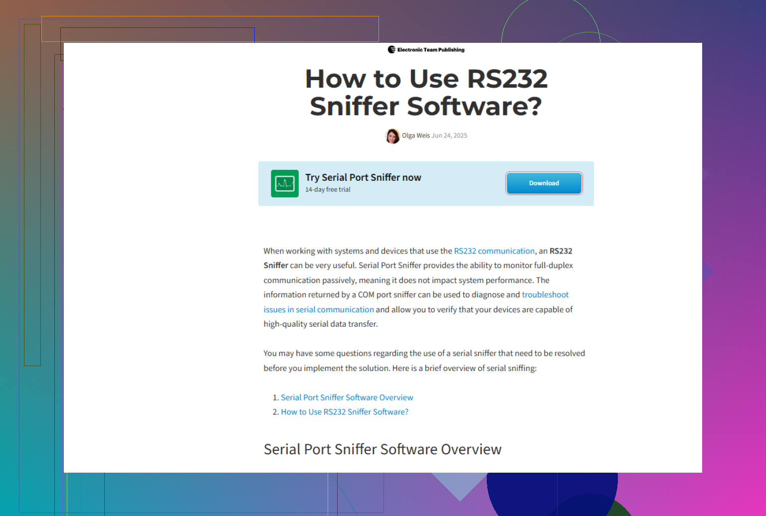

For RS232 specific workflows and tutorials, check something like
RS232 traffic monitor and sniffer guide
They explain how to attach to ports, see live traffic, and decode what your device sends.
